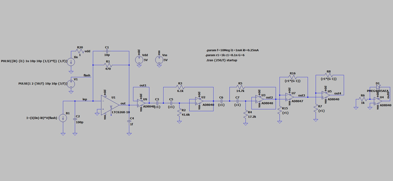

Hello,
In this setup when I change U5 for AD8047, simulation starts, advance a little bit, then due do convergence problems advance extremely slowly.
Any suggestions ?
Thanks.

Hello,
Any suggestions ?
Thanks.

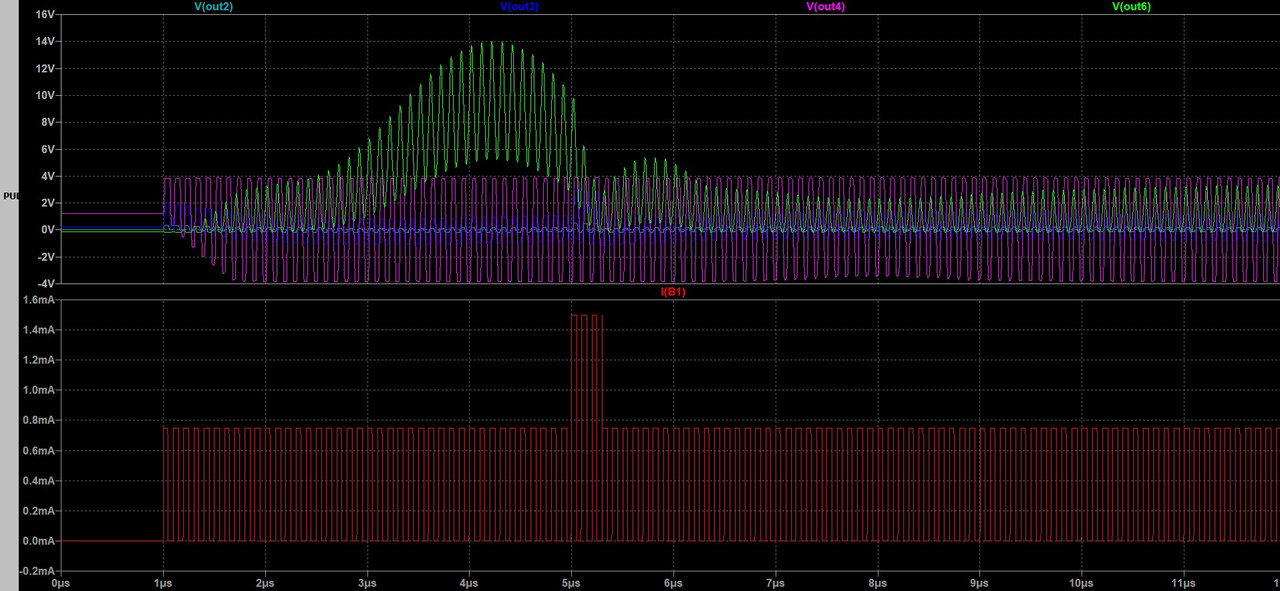

Similar setup, where I changed once more opamps.
Simulation runs until the end ... but can I trust the results (e.g. out6 goes up to 14) ?
Thanks.

Hi Pavel47,
There simulation time of this circuit takes around 200seconds. SPICE Error Log contains a long list of instances of convergence problems.
By changing the last op-amp stage with the AD8040 instead of the AD8047(and connecting R6 to out 5) the simulation is much faster (12 seconds only).
