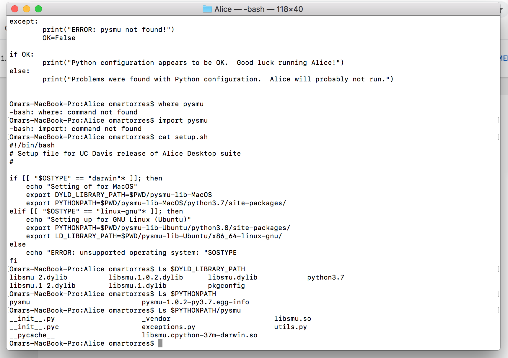

  • Dear Eric and Doug,
    I am reaching out for your help on using ALICE with MAC OS High Sierra.  I am working with a student who has a MAC in preparation for the start of classes.  I unfortunately only have windows10 machines.
    We tried using the instructions at: https://canvas.ucdavis.edu/courses/475222/pages/setting-up-the-alice-software-suite-on-macos-and-ubuntu and the instructions at https://wiki.analog.com/university/tools/m1k/alice/desk-top-users-guide#linux_and_osx but both are giving different problems.
    When using the instructions at ucdavis, unfortunately, it is not finding the pysmu libraries.  Looking at setup.sh in the alice-1.3.7-U directory, since his $OSTYPE is a “darwin”, the commands that should locate the libraries are:
    export DYLD_LIBRARY_PATH=$PWD/pysmu-lib-MacOS
    export PYTHONPATH=$PWD/pysmu-lib-MacOS/pythong3.7/site-packages/
    From these names, I would guess that the pysmu library should be in $PYTHONPATH.  I do not see an “.so” with pysmu in its name (screenshot below) but maybe it is in one of the other so’s?  If it is in one of the other ones, is $PYTHONPATH not the right logical name?
    When using the instructions at wiki.analog, Since these instructions use ALICE 1.3.7, and there is a new 1.3.8 version, we then decided to try the instructions at: https://wiki.analog.com/university/tools/m1k/alice/desk-top-users-guide#linux_and_osx
    However, these are challenging to follow. First note that “libsmu” is not defined anywhere on this page.  I assume these are the ALICE codes/libraries?
     First, note that just after the green box in this area, it says “To manually install on Windows download” which is confusing to begin with, since this section is on linux and osx.  Then it says “for OS X and Linux” and then gives some libsmu versions for Darwin, which are 10.13.6 and 10.14.4.  However, his version of Darwin is darwin17.   Are any of these apprrpriate?  Also, when I go to the link https://github.com/analogdevicesinc/alice/releases I see “assets” for windows (the *-setup.exes) and I see the code.  I do not see any precompiled libraries for OSX
    In conclusion:  right now we cannot get ALICE to work following either set of instructions.  Any help would be greatly appreciated.
    Best
    Sarah Eno
  • my apologies: it will not allow me to upload the screenshot showing the student's work.
  • screenshot of student environment
    Hopefully this will give you access to the screenshot

  • I've repacked the software with the 1.3.8 version of Alice.  I haven't touched any of the code, but just added the precompiled libraries and shell scripts.  Alice-desktop works OK, but still has the same problem I posted with the pull-down checks not updating.
    The DC meter source program just hangs with spinning blue circle of death when I hit Run.  I've tried this on several systems with the same result.   My earlier hacked version of 1.3.7 doesn't hang, so there must be some difference.
    The Linux version just broke completely with a new (ostensibly minor) update to 20.04.  I'm gathering all the details to post at the libsmu issues board.  I'll probably just give up on it and loan the one student with a Linux box a Windows laptop for the quarter.
    Believe me, I have zero desire to spend my time hacking or repackaging your code, but like a lot of people out there, I bought a whole bunch of these modules because I took the "supports MacOS and Linux" at face value, and now I'm struggling to make it work for my students.
